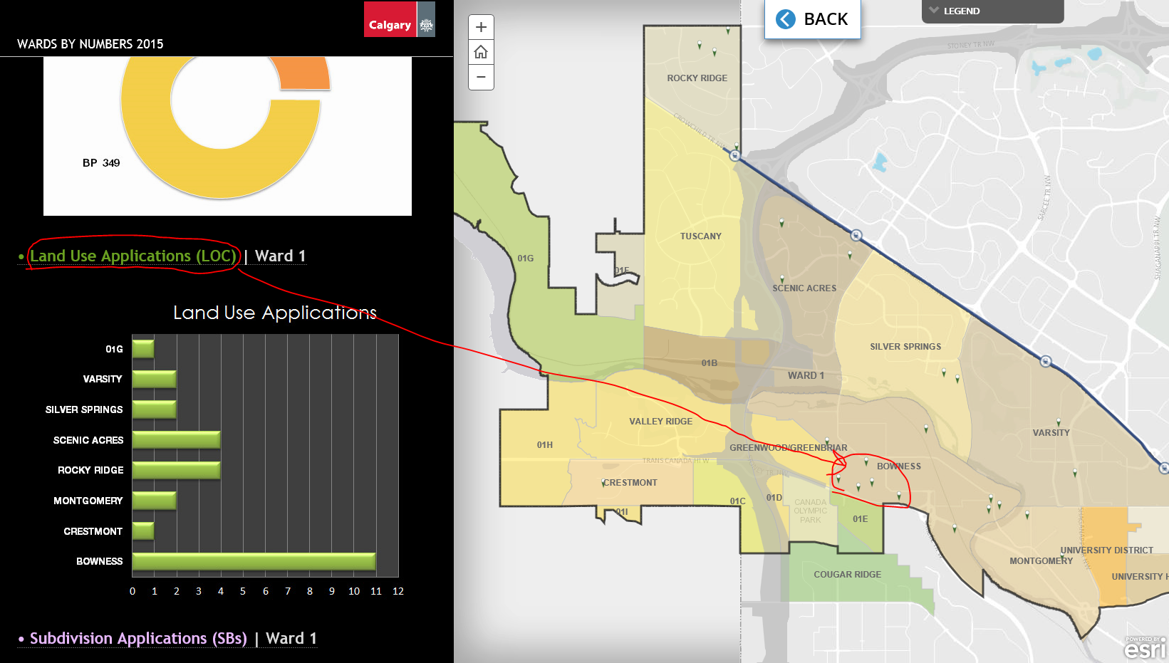

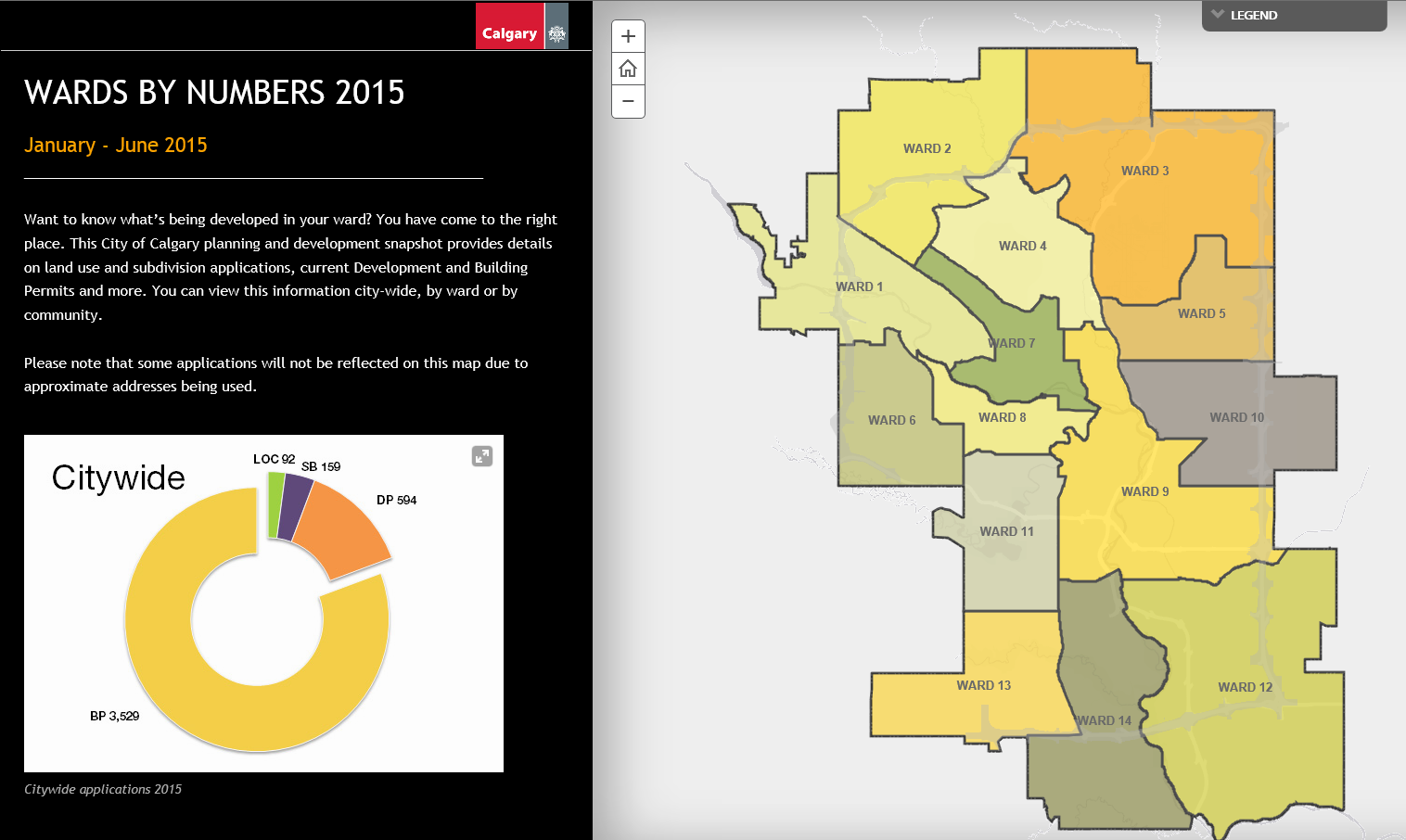

We have an application using the Map Journal template. It looks like this initially:

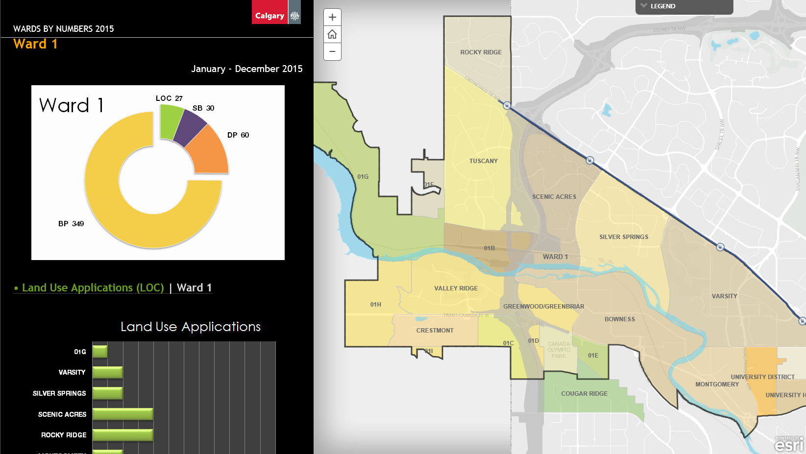

As you scroll down though the journal the map changes as you get to each Ward.
Within each ward there are 4 different graphs showing number of applications/permits by community within the ward (Land Use Applications; Subdivision Applications; Development Permits; Building Permits). When you click the title (i.e. "Land Use Applications (LOC)" in the above picture, the map will change to display the map showing the locations of the selected application / permit):
What I would like to do is have the map display change on it's own so that when the journal scrolls to where the graph is displayed, that the map display would just change to show that data and not require the user to click the header (Land Use Applications (LOC)). As is I don't think it's intuitive enough for them to realize that they need to click the title to have the display change.
