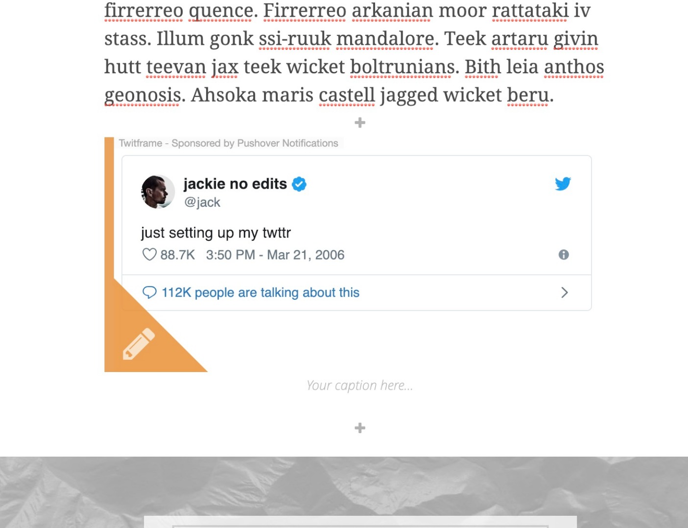

Hi Danielle -- You can just paste your <iframe> code into the Story Map Builder that you are using to embed a tweet. Just look for the "web page" or "link to content" option.
For example, below is a screenshot of your tween inside a Cascade story... I'd recommend using SMALL for the size and enabling interaction in the Appearance tab of the media config options.

when i tried the above method it did not work, (just a blank box with a broken link/face icon) and when trying to find out why - the online guidance said it was because some of the templates you had to edit the json code - the last bit of text on this page
Embed Tweets in your Story Map Journal in 5 Easy Steps
as following the '5 easy steps' didnt work - i followed the instructions to use json instead (as the article says thats why it wont work) - which, as mentioned, didn't work either. Is that not meant to be the case?
is it also correct that you can only embed single tweets, not feeds?
