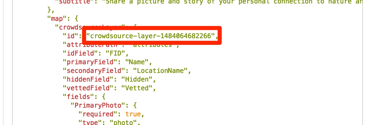

  6. Now choose the app item, scroll down in the data section till you find the map and crowdsource layer reference. Replace this layer id with the id you just copied (Fig. 2).
Fig. 1
Fig. 2
