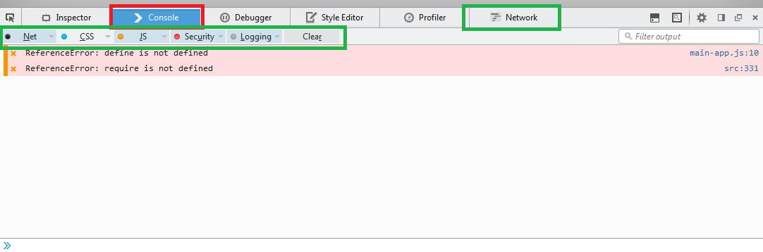

Do you have any error in the Firefox console and network tab?
You can ignore the CSS errors. There is a row of filter Net, CSS, JS, Security), make sure you have Net, JS and Security turned on...
