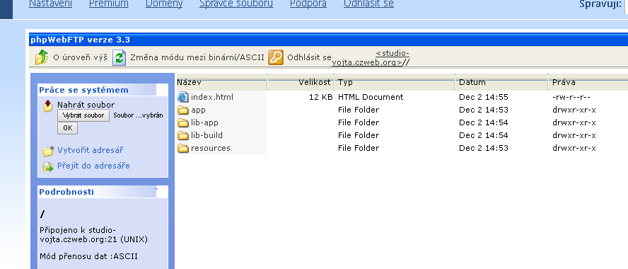

Files on my web

Hi Vojtěch,
Looks like you're running the source code (that's what we mean by "development mode") rather than compiled code.
You can either build a compiled version by yourself or just download it from the link in step 1 of the Instructions section of the GitHub page. You really only need the source code if you are customizing the app. If you just want to host an non-customized version of the app on your own server download the compiled app.
I've included screenshots of the two download links on the Map Journal GitHub page below.
Owen
