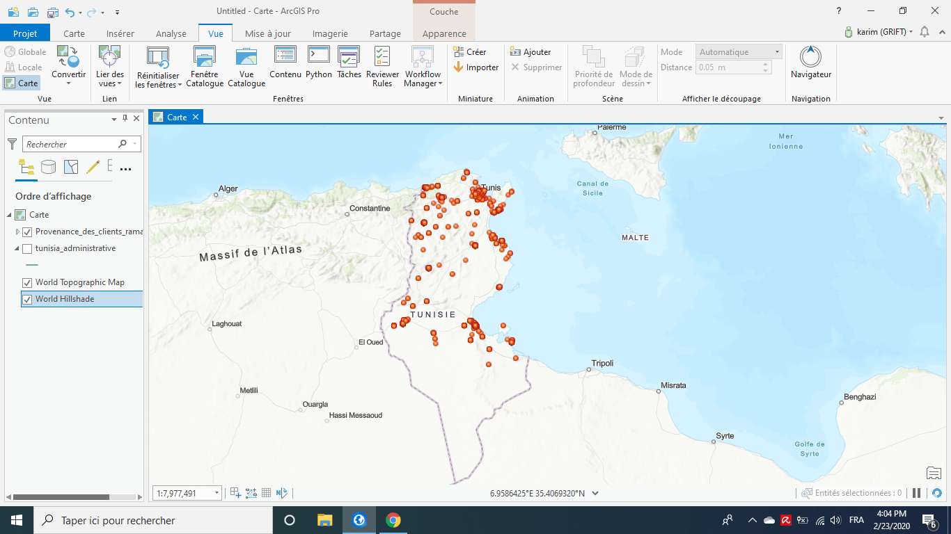

AGOL1SMG
here the map.i've all dots on the map are the customers but i want to show them by density

AGOL1SMG
yes i want it as a points density.and our retails are all the same type (supermarkets)
