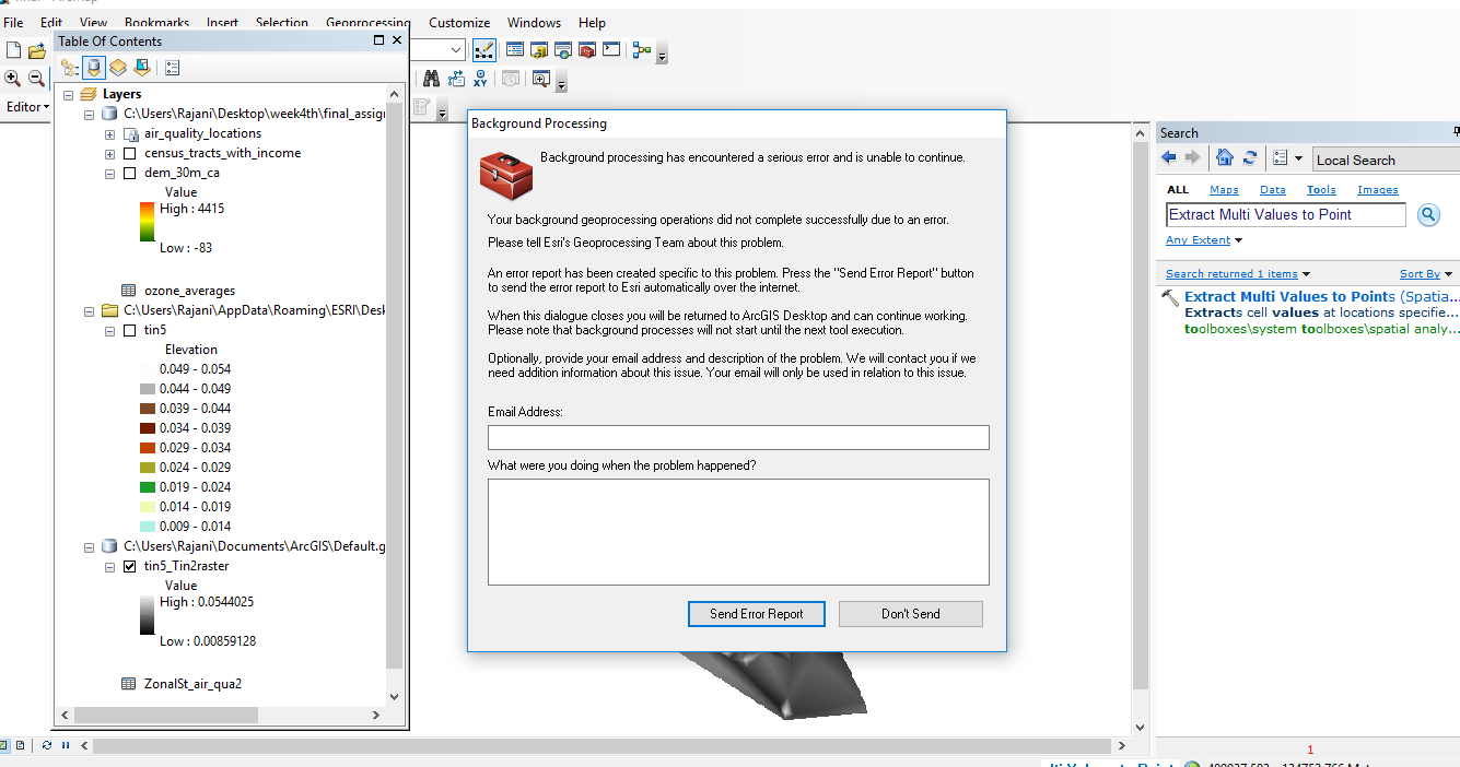

I am not being able to process any work
1101
6
11-12-2017 10:23 PM
laxmiparajuli
My Arcgis show this problem which makes me unable to perform any work. This is what pops out. Need help plz.

Turn off Background Geoprocessing or try what you are doing in ArcGIS Pro

JayantaPoddar
MVP Alum
Hi Laxmi,
Turning off the background processing would be the easier option. Did it not work?
In ArcMap, navigate to Geoprocessing > Geoprocessing Options on the Standard toolbar. Uncheck the box "Enable Background Processing".
Foreground and background processing - ArcGIS Desktop
