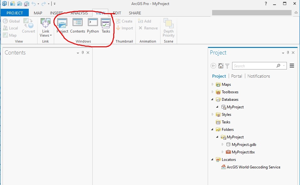

Hi Adrian, Yes I have access to ArcGIS Pro. I've just activated it and am in it now getting the lay of the land. I havePro open right now. The only thing for starters that I can't see is how to open the Catalog window. A online article states to find it in View>Windows and then lick on the catalog pane. But I don't see that option.

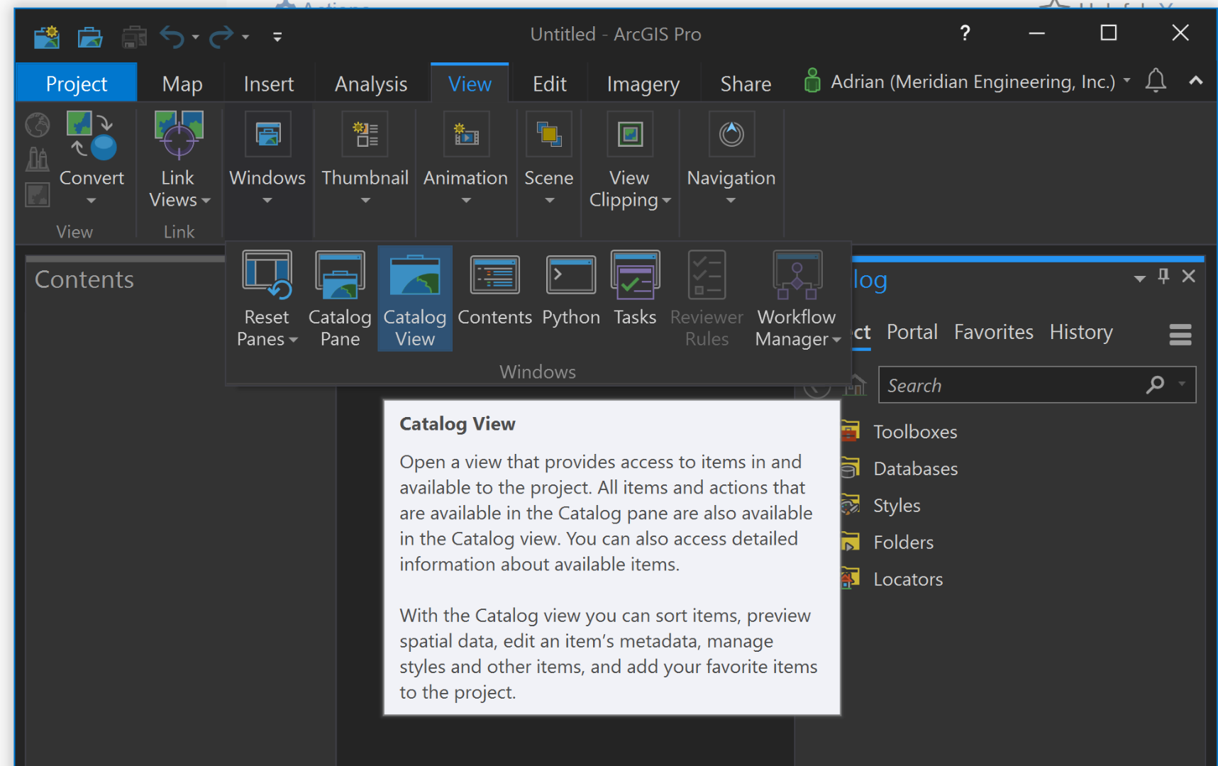

2. I can see your catalog pane right now on the right hand side. That's your catalog pane. You can navigate to your file from there.
3. You can add your CAD file by the Add Data button in the Map ribbon.
4. I wonder if you have the chance to expand your window more. I find that when my Pro application is not fully maximized (full screen) that some of the buttons get shrunk down and end up in a not-easy-to-find drop down list.
5. If nothing else works, right click somewhere in the blank space in the Windows area under the View ribbon, then click on Customize this ribbon. Here you can add your different options like Catalog Pane and Catalog View:

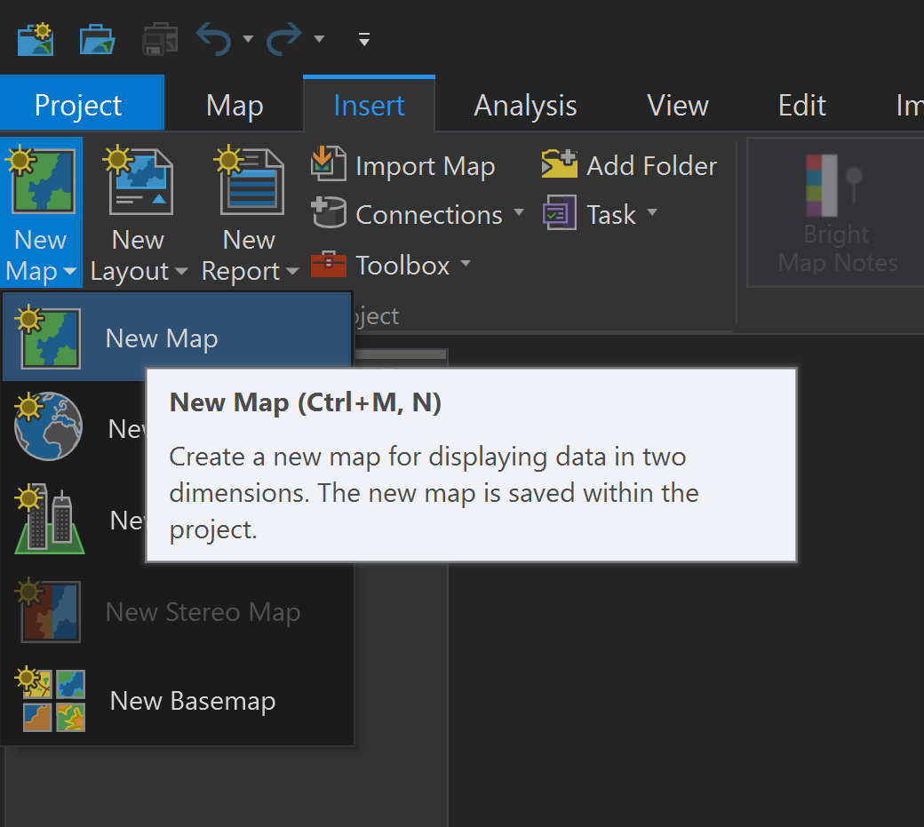

7. One last thing, before you start doing stuff, be sure to insert a Map so you can get started adding data. Without a map, you cannot add data.
PeterSharkey
Yeah I think that's the problem, I'm running Pro 1.2. But I did find the add data button and was able to have some success. What I didn't realize was that I have to add a new map in order to make those ribbon functions turn on. I'm much happier with how it imports cad data. It keeps the line colors and line weights from the original; cad file.
