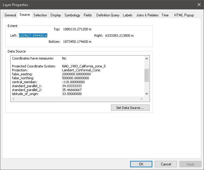

So I have a dilemma with features not lining up with rasters (MrSids) after inserting a basemap from ESRI.  The raster lines up with the basemap, while the features display in the pacific.  I have tried projecting the data to the same coordinate system of the rasters and setting the data frame to the same system.  Is this a problem related to the conversion of CAD to geodatabase tool and the coordinate system assigned?  This picture displays the data correctly, before inserting the basemap.

So, let's see. You have an esri basemap that is projected (obviously).
You have a raster, that is already project? Right (in a custom NAD83 California Zone 5)?
And your CAD data is not projected, I am presuming, right?
It looks like your map data frame is in the custom coord system, but you're saying that the CAD data is showing up in the ocean? (I'm just trying to make sure I am following).

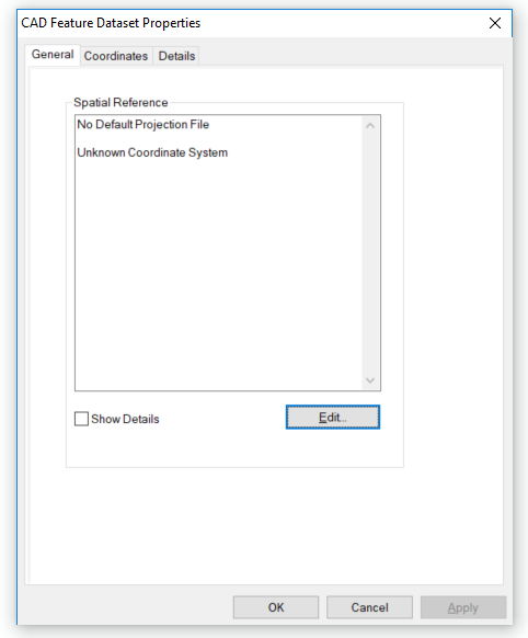

Try this, start a new map just to make sure there are no inherent issues, and in the catalog pane in ArcMap, navigate to the CAD data, right click on it, and in the General tab, click on Edit under the Spatial Reference, and then choose the custom coordinate system that this CAD dataset belongs in
Then you should be able to add it to the map and the map's data frame should reflect that system (and if this is where it is supposed to be, it should line up properly).
JesseAguilar1
Yes, you are correct to assume the CAD data had an unknown coordinate system, this was taken care of when the dwg file was converted to a geodatabase and into a dataset.

MelitaKennedy
Esri Notable Contributor
The CAD data looks like the units are in US survey feet, while the CA 5 coordinate system definition is using meters. Use the data's property page to change the coordinate system.
