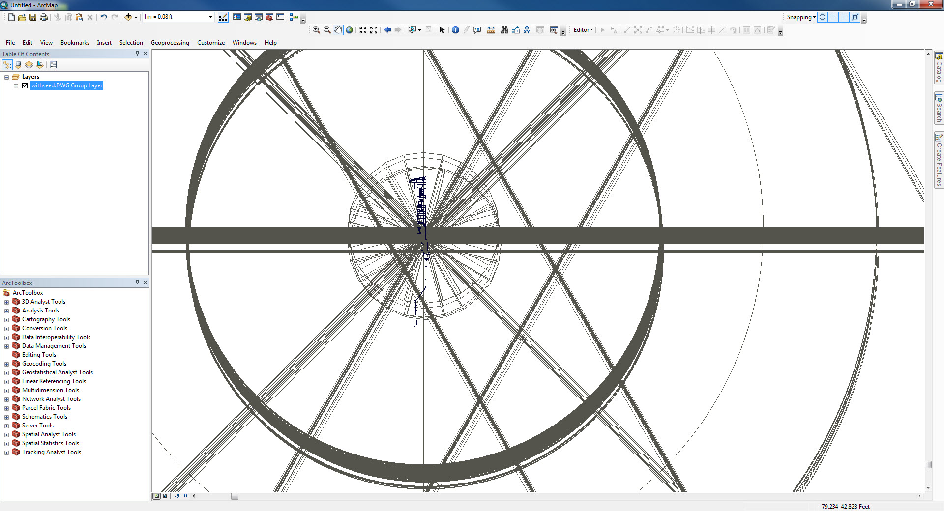

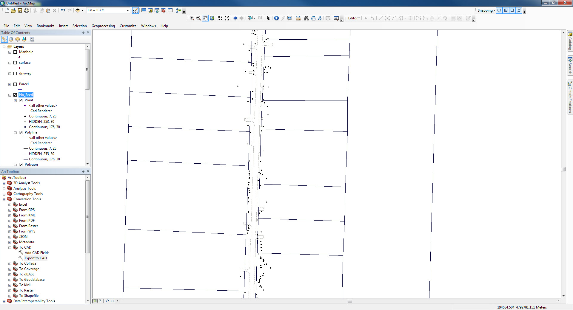

Whenever I try exporting to CAD in ArcMap without a seed file attached the dwg lines up correctly with the shapefile. When I add a seed file the size of the blocks becomes tiny and the entire dwg moves to completely different location on my map.It is supposed to be Erie County in New York. The shapefiles are in WGS 84. Any help is much appreciated.This is image show what the dwg looks like with a seed fileThis is image show what the dwg looks like without a seed file
