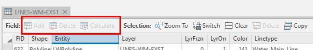

I'm trying to edit an attribute table and from what I can see the table is not editable currently as the Add/Delete/Calculate buttons are greyed out. I've been trying to find a tutorial on this but what I've found starts off with the assumption that a table is editable.

You cannot edit CAD data directly. You have to convert it to a feature class first (shapefile, file geodatabase, etc.).
If you're using ArcMap and already have a feature class, you first need to start an Edit Session. From the Editor toolbar above (if it's not there, go to Customize --> Toolbars --> Editor), click on the drop down menu and select Start Editing.

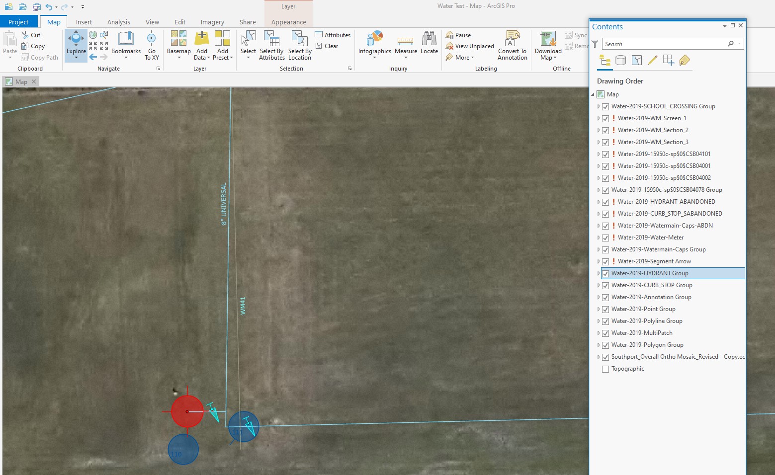

The first screenshot shows my Autocad file imported. The colors of the lines now in ArcGIS are the same as Autocad which is awesome and everything is on separate layers same as Autocad.

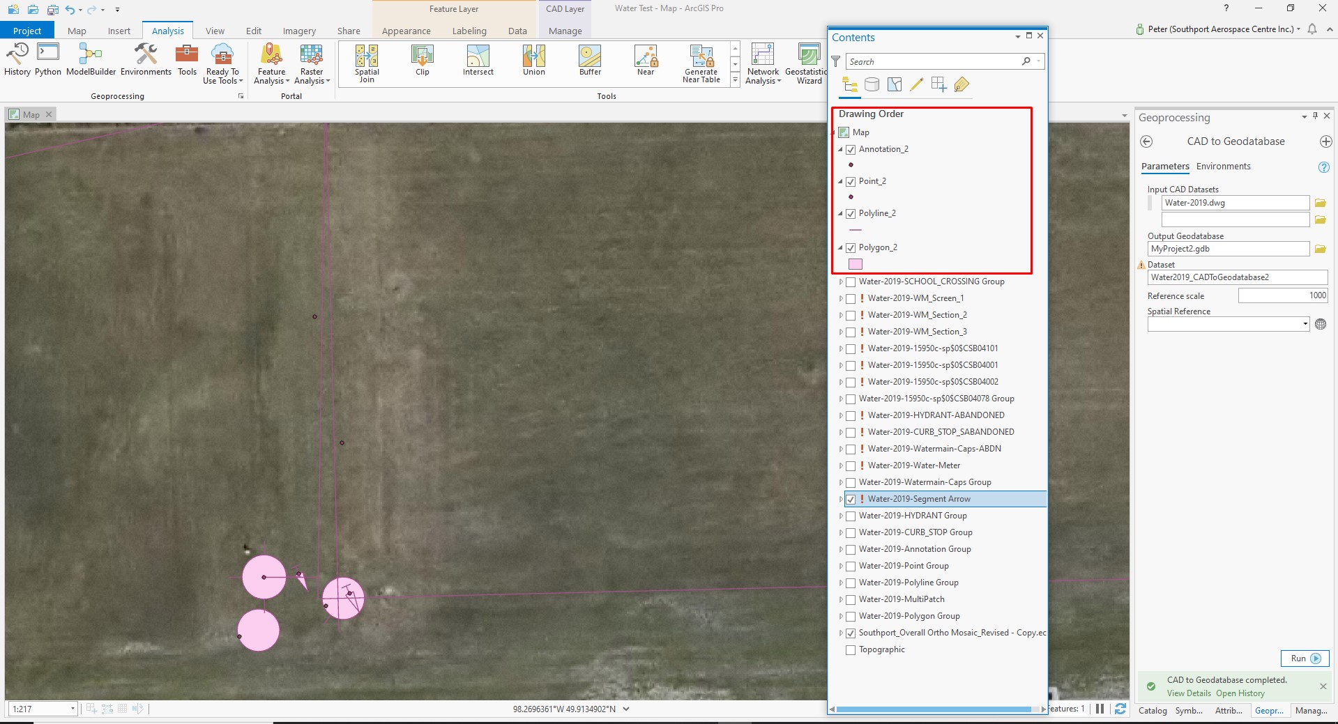

This next image shows what the content looks like after the CAD to Geodatabase runs. I shut off all the Autocad layers and leave the new Geodatabase content on (shown in red). But now all of the annotation is gone, all of the original Autocad colors have switched to something else by default, and all of the geometry has been condensed into only a few layers. Not what I wanted.
AdrianWelsh
MVP Honored Contributor
Yeah, looks like standard behavior. CAD and GIS aren't the best of friends.

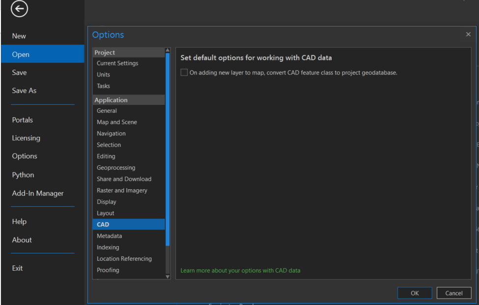

One option that might solve many of your issues is to go to the Project ribbon (upper left), then Options, then CAD, and check on the box:
For your annotation, right click on the layer, and turn on the labels. You may have to mess around with the labels some (in labelling properties) to get what you want.
PeterSharkey
Wow, that was actually a pretty easy way to turn the labelling on.
