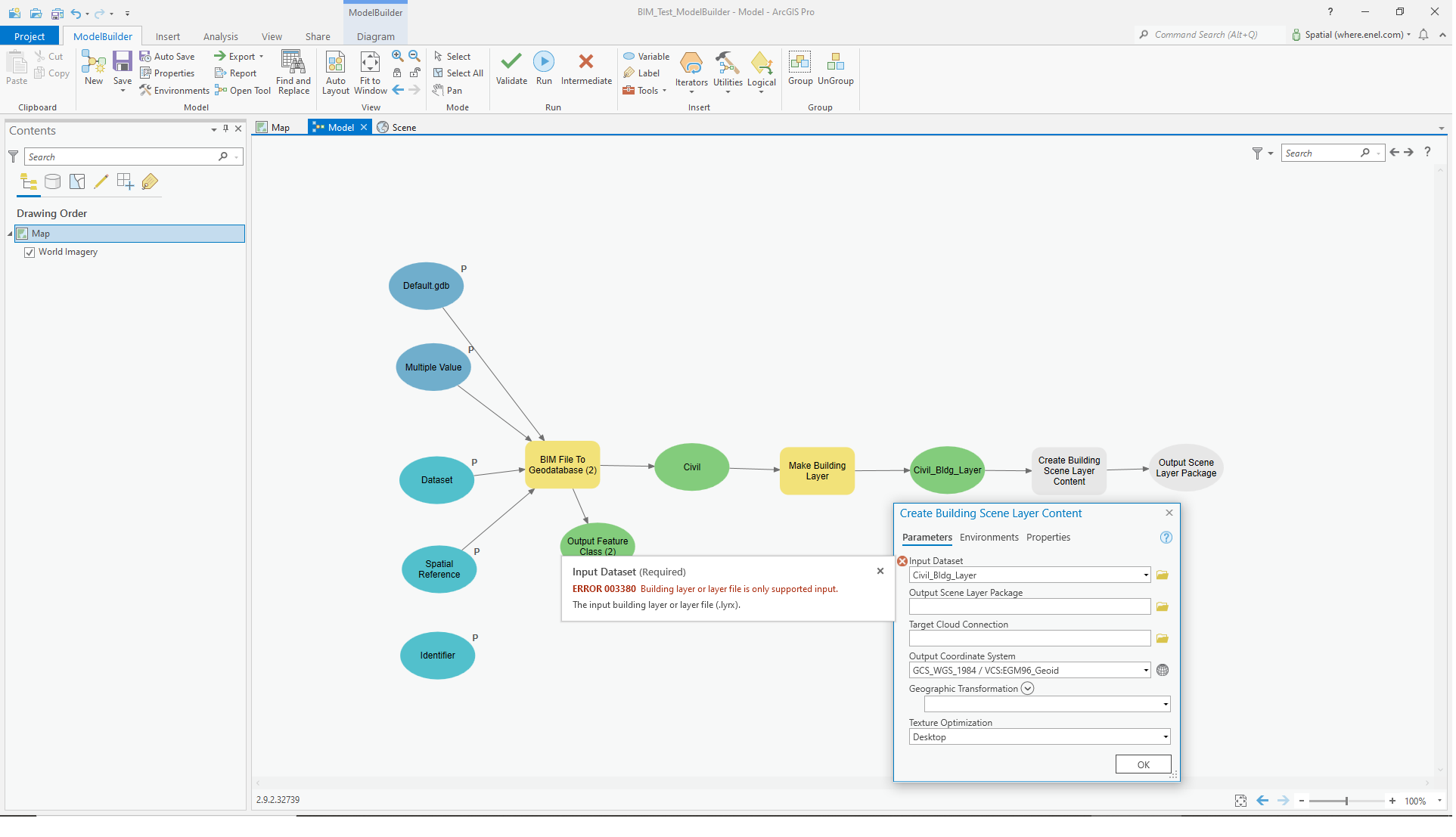

In ArcGIS Pro 2.9.2 the process of converting BIM .ifc files by manually running these tools in order works fine:
  1. BIM File to Geodatabase
  2. Make Building Layer
  3. Create Building Scene Layer Content
However trying to run these same tools in Model Builder fails. I contacted ESRI support and there is a known bug for this issue: BUG-000144891  Hopefully will be resolved soon, as running this process in Model Builder is much more efficient than doing this manually if you have multiple large BIM datasets to convert.
