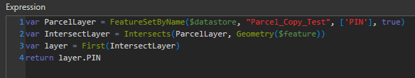

Success Thus Far: I am working with a point layer and a parcel layer. When a point feature is created inside a polygon parcel, the parcel number is passed from the parcel polygon layer to a parcel number field in the point feature class. This works great and below is my successful Arcade expression for the AR.

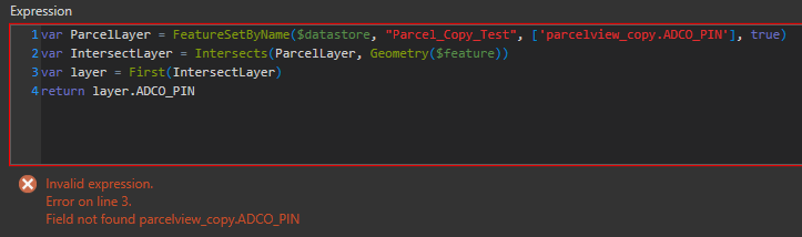

Current Challenge: I have a standalone table residing in the same geodatabase that house the point and parcel feature classes. The table is called "parcelview_copy". This table contains additional information about parcels and I have joined this table to the parcel polygon feature class within Pro. I want to pass a different PIN field, "ADCO_PIN" to the point feature class when a point is created within a parcel. I get this error in the Arcade expression below.
I'm not really sure what I'm doing wrong or if joined tables are supported by AR?

It won't be possible to access joined fields using attribute rules.  Joins exist only in the "current session" - this one particular Pro project - whereas attribute rules are stored in the geodatabase so that they can be executed from anywhere the data is accessed.
