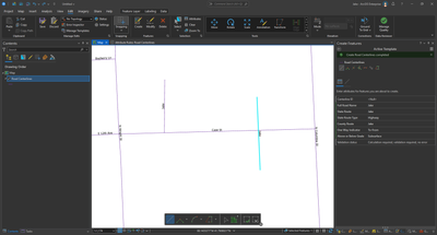

Using some ADMS sample data I inserted two lines. One who's end vertices intersects a line and one that overlaps. I preconfigured the field values so that the insert would have values.

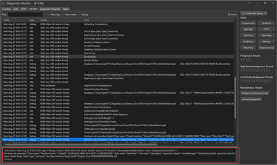

When running the planarize tool against these features I get the same result. I went to the ArcGIS Pro Diagnostic Monitor and ran the planarize tool again to see what the logs showed. It shows that the rule is firing and logging the error.
If we can apply the rule below check what fields are empty to cause the rule to trigger the error message. The output is a concatenated list of all empty fields

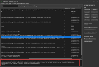

Looking at the logs it shows that there is an attempted insert with empty fields.
This validates why you are not seeing your first rule (var returnErrorMsg = True) triggering on insert and why the planarize tool does not complete. There is an underlying insert within the planarize tools code that inserts an empty row into the data source, that on this insert your code runs against empty values, returns an error without you seeing because that insert is not processed by the UI and thus the planarize would fail.
This tells us that with the Planarize tool there is an empty insert and then an update.
So with your current rule, one I copied with my field values, this may be expected behavior that the planarize tool 'fails'. But you can contact technical support to verify.
