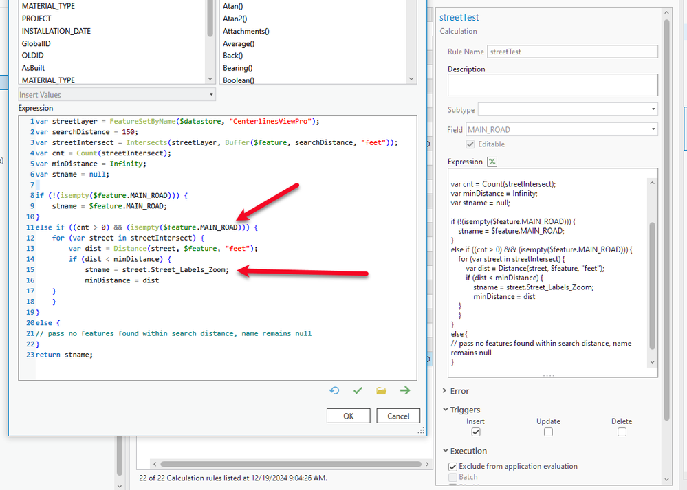

RhettZufelt
MVP Notable Contributor
 I copied your code and updated for street featureclass name and fields and seems to be working as expected.  Auto assigns the closest street name, but, If I change it in the attribute table (I have domain dropdown on this field), it will update to whatever street I select and stick.
Only thing I really see different is that my street field names are different in my lookup street centerline layer and the target layer.
Line 15 should have the field name containing the streetname in your FeatureSetByName($datastore, "StreetCenterline") layer.
MAIN_ROAD = streetname field in target layer
Street_Lables_Zoom = streetname field in lookup layer
