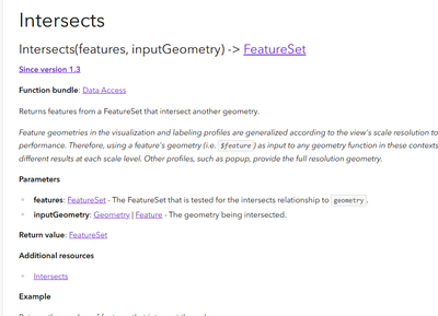

Your "Intersects" is backwards.
**EDIT: Also, it returns a featureset, so you need to do a count.  updated the code

var fibercable = FeaturesetByName($datastore,"attributeruletest.sde.fibercable", ['*'], true);
if(Count(intersects(fibercable,Geometry($feature))) > 0)
