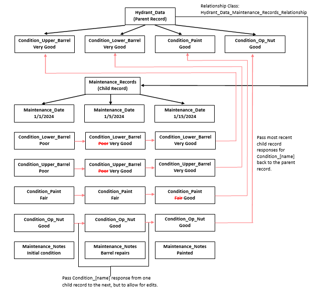

The attached workflow is what I'm trying to achieve.
Right now I have it structured to pass the child-to-child and child-to-parent using the script below as a calculation constraint.

This works in terms of passing the records from one to another, however, because it is a calculation, it doesn't allow for updates/edits to the child responses to indicate the change in condition status in response to the maintenance work performed. Am I thinking about this wrong? Should the child-to-child record passing, that is then editable, not be done via a calculation constraint?
