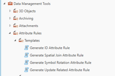

You can set up #1 using a templated AR - https://pro.arcgis.com/en/pro-app/latest/help/data/geodatabases/overview/template-attribute-rules.ht...
For number #2, I would suggest using a database sequence(also in the templated rule), and not rely on querying for a pole, that could lead to a racing condition and duplicate ids.
YumkhaibamKabirAhmad
Thank you the suggestion @ Mike, but template option is not available in my ArcPRO(3.5).
MikeMillerGIS
Esri Frequent Contributor
It should be, they where first included in 3.4.
Try here -
or here
The Templates option are not in 3.5 pro version, anyway thank you very much Mike, Im able to solve the problem. Thanks for your guidance.
