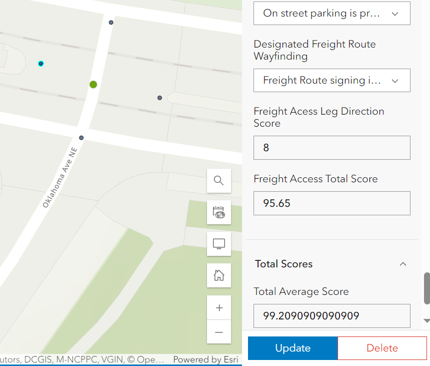

I have features with calculated expressions that take values from nearby points and produce a shared final score. The issue I am facing is that when an additional point is created or one point is edited, all the other points need to be selected individually to be updated. In the picture below, there are four black points for each leg of an intersection. After each point is created and their forms are completed, the user has to go back and click each point individually to reupdate each point once again. Since any change to one point affects all 4.
I am wondering if there is a way to add to the arcade code to automatically update. Or any other workarounds that would solve this problem.

To further clarify also, other calculated fields update automatically, like the "Freight Access Leg Direction Score" shown in the picture. But this field does not since its calculation involves other points.
