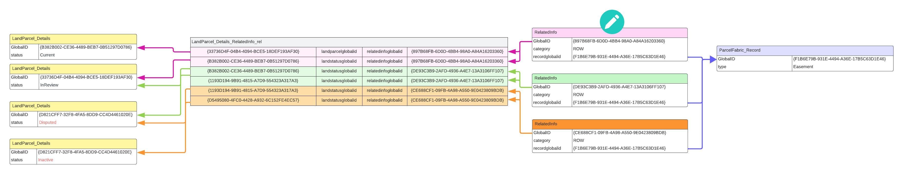

I have a constraint attribute rule expression that iterates over each feature in a FeatureSet (RelatedInfo table), and looks at a relationship class (LandParcel_Details_RelatedInfo_rel), which is M:N, for matching RelatedInfo GlobalIDs and returns all the Origin Foreign Keys for the LandParcel_Details Table.  I use those Origin Foreign Keys to query LandParcel_Details Table and do checks. This is all in a file geodatabase.
An example of the relationships look like this
Still with me? Great!

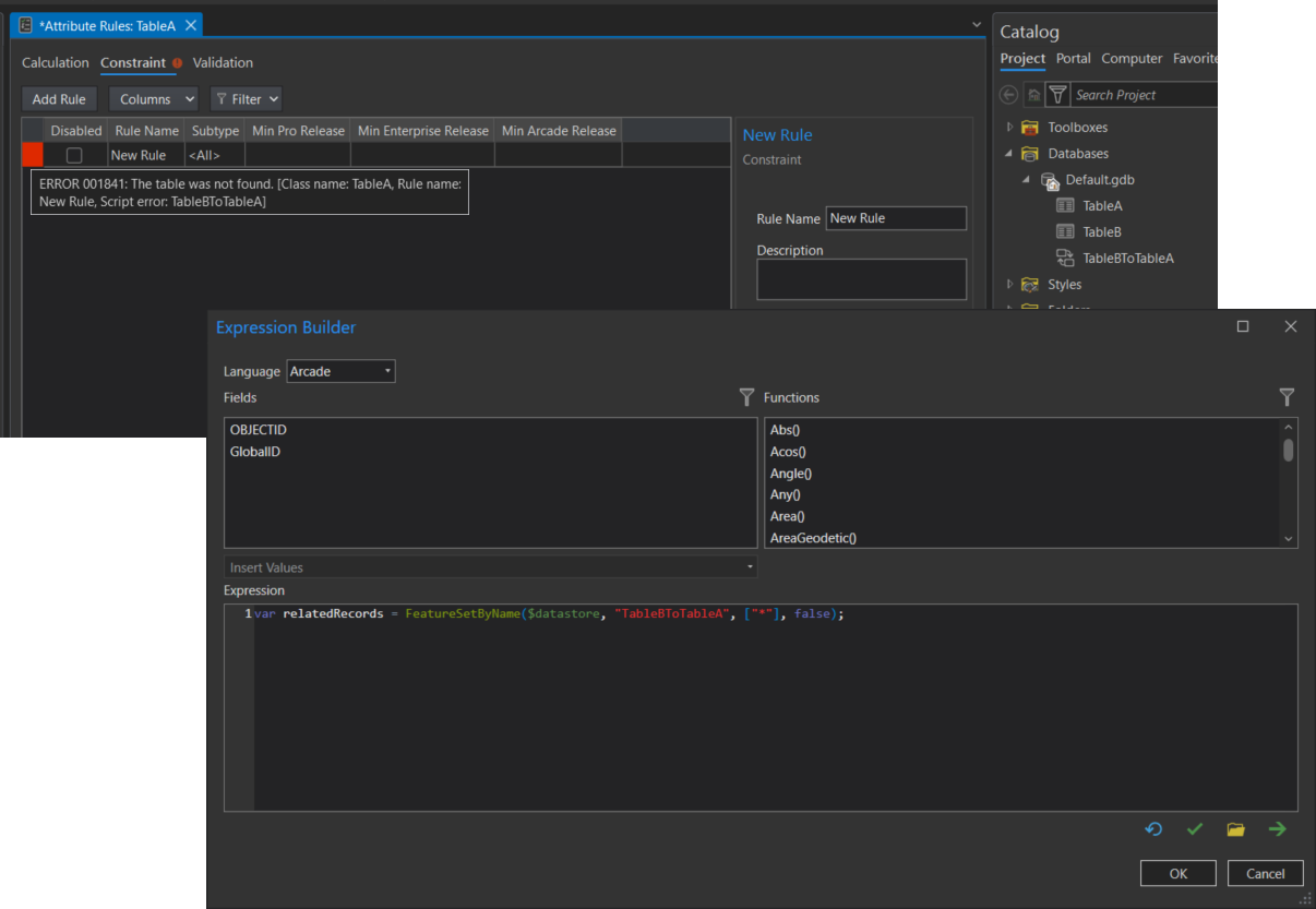

Sent it to the some folks for testing and they got an error when they tried to save the attribute rule that the LandParcel_Details_RelatedInfo_rel relationship table cannot be found. It was working on my file geodatabase, which is the same data. Yet when we work with a new copy of the same file geodatabase, now we get an error when we try to save the attribute rule that the LandParcel_Details_RelatedInfo_rel relationship cannot be found. Example below with dummy data.
So at some point it was working. Then at some point it stopped. The really weird stuff happened when doing other testing, writing console logs and error messaging for code validation, and getting a successful attribute rule save and run (similar code but with the consoles or error messages), then replace that rules expression with the one that was working then didn't, it saved. If you deleted the rule and reapply a new rule it saved. If you deleted the file geodatabase and create a new copy (we have a zip file we just unzip a new copy) the error then persists.

If you look at the original code below, the function getRelatedLandParcelGlobalIDs takes in a list of RelatedInfo GlobalIDs, filters the LandParcel_Details_RelatedInfo_rel relationship class for matches, then loops through and creates a dictionary of RelatedInfo GlobalIDs and all LandParcel_Details GlobalIDS that match returning something like:
{"relatedinfoglobalid":"{8BC198FA-89F3-4924-A1B3-7B1586A80E3A}","landparcelglobalid":"{F09CB8F5-6E83-4A80-A3C3-5113BFF60AF2}","{03382B6C-BAD3-4E13-A9DD-20061D8F4424}","{9F5EEA9E-9620-4176-A14F-1B053085D017}"},
{"relatedinfoglobalid":"{36591372-61C1-4D66-B1BF-65517BD5B100}","landparcelglobalid":"{03382B6C-BAD3-4E13-A9DD-20061D8F4424}","{9F5EEA9E-9620-4176-A14F-1B053085D017}","{3700974E-0ED4-455C-9908-42D5252D4131}"}
This dictionary is pushed into an array in which I use to go get matching records in the LandParcel table to do other checks.

Update.....upgrading to ArcGIS Pro 3.4 fixes the crash issue. It does not, however, fix the issue with calling a relationship class using the FeatureSetByName function.
