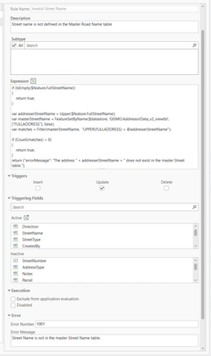

Here is the configuration to my rule. There are no other rules with this error message.
SarahWright
The table name is slightly different in my picture. Another variation I tried to see if it would connect to another table.
