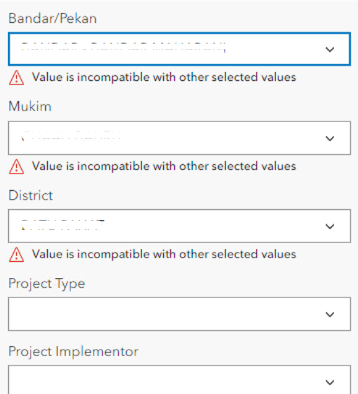

Hello peeps,
I have encountered issues for contingent value in ArcGIS Enterprise 11.1 and hoping that this community can shed me some lights on this.

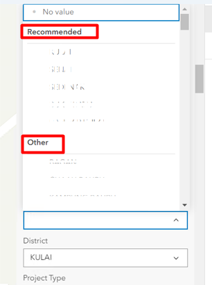

I have configured the contingent value and I often get these errors "Value is incompatible with other selected value" when I try to create new feature in MapViewer. Eventhough I am pretty sure that the value I have selected match with the contingent value I have configured.
And I believe the reasons for these error is because the recommended list of contingent value that it should appeared is just not appearing and most of the times, it will displayed the full list of the domain despite I have configured the contingent value for the particular field. And when I try to pull the service and edit it ArcGIS Pro, the contingent value works just fine. It literally confused me.
Appreciate if anyone could share me some insights on where I should be checking at. Many thanks!
*Published as reference layer
