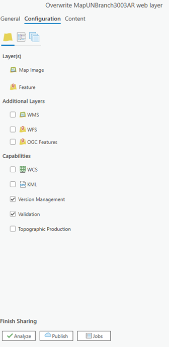

The classx is registered as branch version and validation feature class like other feature and the weblayer has been published using version managment and validation option.

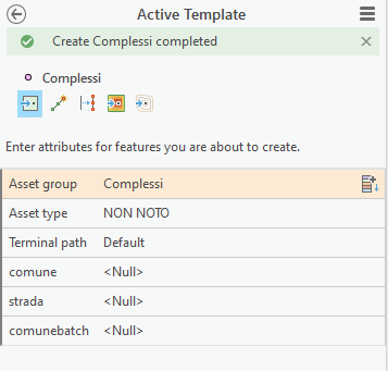

Now, when I consume within arcgis pro the weblayer and I try to add a feature within device the element is added but  the field "COMUNE" is empty and no errors appear. Maybe the rule was never executed. Why the classx name has been translate in a code? Which log I can control to understand and solve this issue?
