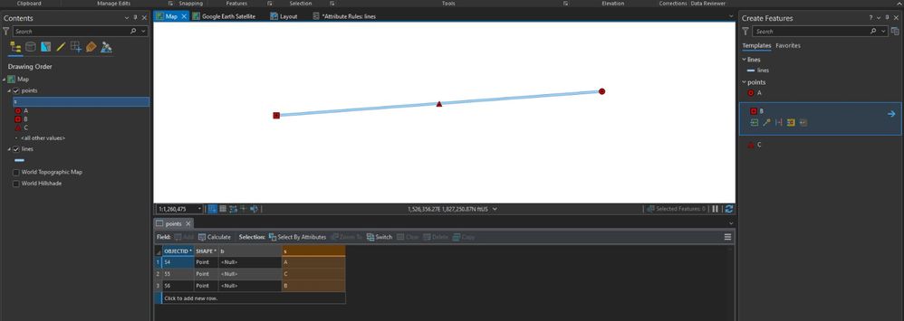

If I assign a subtype to the point feature, can I define a specific value to be edited؟
like this image:
WhatsApp Image 2024-10-09 at 2.22.35 PM.jpegWhatsApp Image 2024-10-09 at 2.22.35 PM.jpeg
TedHoward2
You can include attributes in the newly created points. Please see attribute rules doc.
