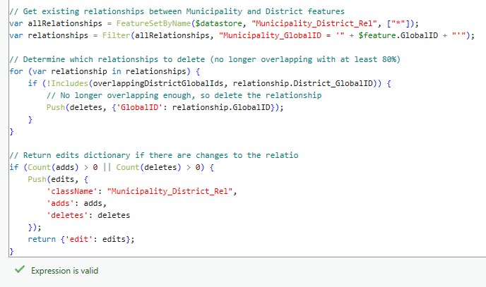

When I click Analyze I get:

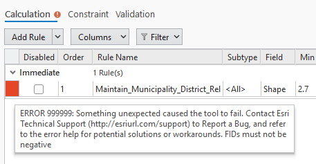

But when I try to save the attribute rule I get this:
What am I doing wrong?

Thanks Mike,
but unfortunately I get the same error. My initial though was a version issue. I am using ArcGIS Pro 3.3, but I get the same error message on ArcGIS 3.5.
The line that causes the error is: var allRelationships = FeatureSetByName($datastore, "Municipality_District_Rel", ["*"]);
But, it's the only way I can think of to delete the existing relationships.
Could this be a bug?
