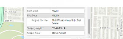

I had tried the above with a new separate attribute rule but when deleting a feature from Projects_B, the value is still retained in the project_number of the underlying intersecting Projects_A feature class unfortunately

Sounds good, I've tested the logic to see if it works with the above and upon deletion, and panning around, I still get the same result that shows in the pop up still for Projects A with the project_number still there.
I tried deleting via deleting the row in the attribute table for Projects B as well as deleting via the edit ribbon for Projects B.
