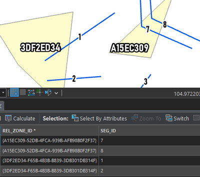

I have a polygon feature class related to a table via Relationship Class (one-to-many, GlobalID in polygon related to a GUID in the table, field called REL_ZONE_ID). I am updating this related table manually. The related table lists the segments that intersect the polygons (polygon labels shown here are a shorthand version of the full Globals, full version listed in the REL_ZONE_ID field). So basically it's a table that keeps track of the lines intersecting a given polygon.
I am moving between Pro 3.1 and 3.2, so I can't yet reliably use "FeatureSetByRelationshipClass".
The table shown is the related table, storing a record of each line that intersects a polygon.The table shown is the related table, storing a record of each line that intersects a polygon.
