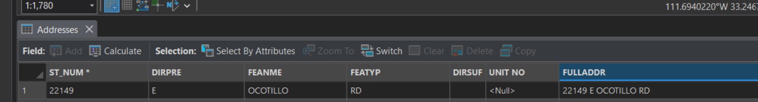

Hello! I am working on an attribute rule that will concatenate 6 fields that make up a street address to create a full address. The problem is that 2 of the fields are not always populated with a value. They will either be null or empty.
In the image below, you can see my 6 fields (ST_NUM, DIRPRE, FEANME, FEATYP, DIRSUF and Unit (LV_APT)
If I do a simple concatenate of those fields, the result will leave spaces at the end of the full address. I know this is because of there not always being a value in DIRSUF or LV_APT.
I have been working on the below code, but I know I am missing some parts. Any ideas or anyone know a better way?
