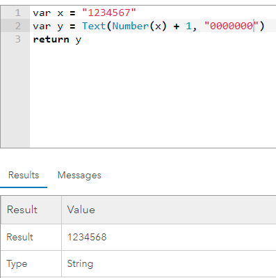

JohannesLindner
MVP Alum
Hmmm, it seems to work:
Can you give an example of original values where it doesn't return the correct value?
Can you post the whole code, maybe your problem is in another part?
Have a great day!
Johannes
Aнастасия88
Thanks for your reply!
I just realised that there is a threshold in digit number to convert string to number. 16 digits works but if it is more than that, it does not work.
Now I am thinking of split the text, convert them to number to update the value, and then concatenate them back to text. But is there any other better way to achieve this?
