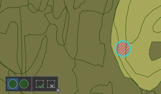

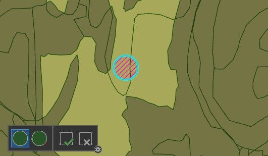

Update that I would like to do is, once the buffer is moved, then the originally intersected features of ParkA are deleted form NationalPark layer , and then the new intersected features of ParkA are added to NationalPark layer accroding to the new position of the buffer - please see pictures below.
I would like to set up the update function via batch calculation of attribute rules as a final goal - is this possible?
For example, insert a buffer and before move the buffer,
And then once buffer is moved, it should be like this
