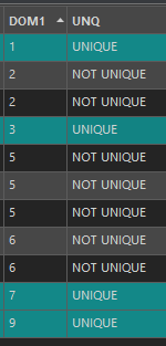

I am trying to write an Attribute Rule to report on whether a value in a field is unique within the entire field (unique IDs for features, for example). I am aware of things like database sequences, GlobalIDs, and GUIDs--that's not what this question is about. I'm using ArcGIS Pro 3.1.1, and my data is in a local File Geodatabase.
The uniqueness "reporting" will be done in a separate field. The image below shows this.
The code below achieves the result above; however, this is done using Field Calculator:

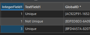

Thanks for the reply! If you have any idea why my version works via Field Calculator but not as an Attribute Rule, I would love to hear it. Must be something about how a script executes in one environment vs. the other?
This script sort of works, but it still doesn't address updating both rows once an ID becomes a duplicate. In other words, if I update row 1 to be "9", then row 2, which is already "9", should also be marked as a duplicate. Currently, that doesn't seem to happen.
Below, I have changed the first row from "8" to "9", and the "UNQ" field in that row correctly updates to "Not Unique." However, the second row, which is now ALSO a duplicate (value = "9"), does not receive the same update in the "UNQ" field. To be clear, I have also saved all edits. Perhaps this type of update is not possible? I tried with a fresh feature class using your field names as well, just to be sure.
BUT, if I manually change the second row to some other value, then back to "9", I get the correct reporting in the uniqueness field for that row as well, as expected.
THEN, if I delete the second row, the first row (the one that remains, undeleted) will correctly update from "Not Unique" to the correct "Unique":

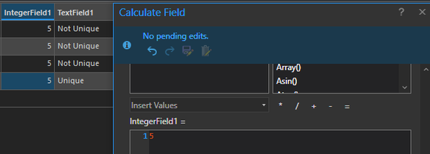

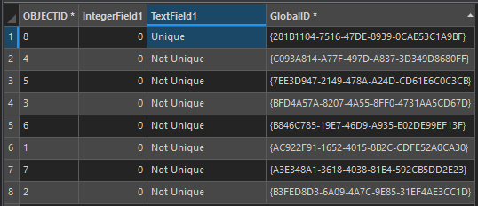

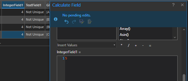

@JohannesLindner one more question for you--I think I've managed to break this using Field Calculator (as Field Calculator often has the power to do...).
Here is the feature class table correctly reporting on the "uniqueness" of each of the IDs. As the screenshot shows, I have a pending calculation for the entireIntegerField1 column.
And here we are after the calculation. Note there are no pending edits here, and the table has been refreshed. In my testing, it seems like every record processes correctly, except the last row processed, which is typically (or always?) the last ObjectID.
So, for some reason, Field Calculator processes the given calculation for each row, and then kicks out at the last row without activating the Attribute Rule maybe? Or perhaps, Field Calculator is iterating over a temporary copy of the rows in such a way that at the very last row, it's the only row "left" in memory, and since there are no other rows to compare the value to, it will always report "Unique?" Any other ideas you have would be fantastic.
Here's another one with the @OID shown (sort in this case based on the GlobalID).
