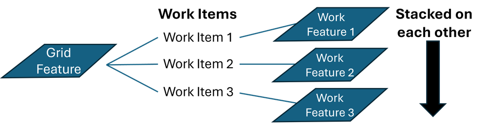

Below is a graphic of my intended data model - Hopefully it helps.

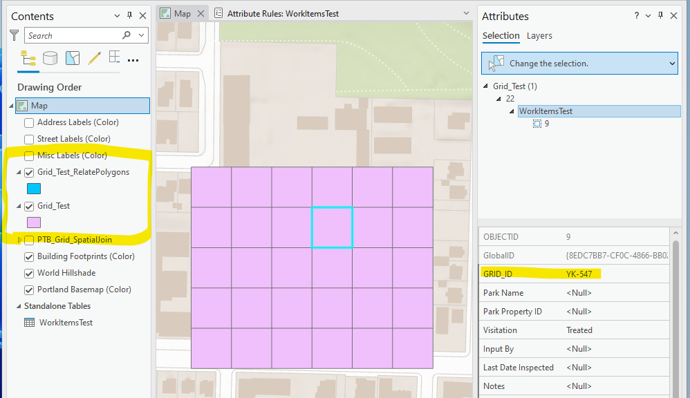

I replaced my old script with this one and got no errors but the geometry/attribute is still not coming over and transferring to Grid_Test_RelatePolygons.
Whats odd is I know there is a connection to the parent feature because grid_id is populated automatically when I add a new record in the non-spatial table (WorkItemsTest) from the first attribute rule I posted.
See the screenshot of the related record being added to the non-spatail table (WorkItemsTest) - and getting the grid id from the parent feature but not adding anything to Grid_Test_RelatePolygons (symbology is blue)
you can see in the attribute table for Grid_Test_RelatePolygons that nothing is being added too.
Highlight area shows no records.Highlight area shows no records.
