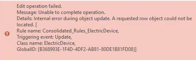

@HusseinNasser2I’m seeing the same error on the UN's ElectricDevice feature layer in a feature server while executing Calculation rule. Tried console() for logging in ArcGIS Pro, but no messages are being printed.
I am using ArcGIS Pro 3.3.1.
Background: In this calculation rule, I am returning edit payload to update three feature layers,
1. Another feature than $feature in ElectricDevice
2. ElectricJunction
3. ElectricLine
I this is the only calculation rule applied on ElectricDevice feature layer
Below is the error message:

Thank you @HusseinNasser2  for your input, it helped me to resolve the issue.  However  a console was not visible after enabling logging on Pro arcgis monitor to see the arcade messages.
Root cause: I was making edit return as:: {"edit": [{"className": "ElectricDevice", "objectid: 1234, "attributes": {"status": 4}}]}
Solution: As a fix I am now using "globalid" instead of "objectid" to uniquely denote the feature being edited as below:
{"edit": [{"className": "ElectricDevice", "globalid:  "{dfd-23cf-dfd-dsf-3434df}", "attributes": {"status": 4}}]}
Reason I was using objectid earlier: Sometimes I encounter cyclic errors in certain calculation rules when using globalid. However, when I switch to objectid, the cyclic error does not occur. I’m not sure of the reason behind this behavior, but it’s something I’ve observed.
As a practice what shall we use 'globalid' or 'objectid'? I would appreciate your inputs, if you can suggest possible approaches to overcome the cyclic error?
