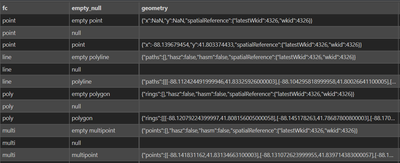

PaulLeBlanc1
This function differentiates between null and empty geometries.
function empty_null_shape(geo) {
    return Decode(TypeOf(geo),
        "", "null",
        "Point", IIF(IsNan(geo.X), "empty point", "point"),
        "Polyline", IIF(Count(geo.paths) == 0, "empty polyline", "polyline"),
        "Polygon", IIF(Count(geo.rings) == 0, "empty polygon", "polygon"),
        "Multipoint", IIF(Count(geo.points) == 0, "empty multipoint", "multipoint"),
        "?" // Default
