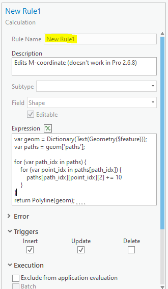

When an attribute rules is saved, it's Field value becomes read-only:
It would be helpful if the field could be changed — even for existing attribute rules.

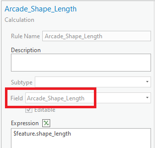

AndrewQuee
This also applies to the 'editable' feature for calculation rules.  If you did not want to let users edit this field (say you are populating a DB sequence by calculation) and forgot to untick it, or if you change your mind later about editability, you cannot toggle this option.  (Greyed out as shown)
Your only recourse then is to delete the entire rule and recreate it.
RhettZufelt
It appears as if you can copy/paste the rule, modify it, then delete the original.
Still a pain.  Can see the box right there, why can't we change it.....
