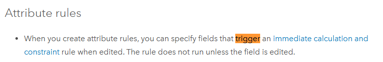

HusseinNasser2
Status changed to: In Product Plan
This is now possible with Pro 3.4 (You can test it with the Beta 1) with Attribute Rules Triggering Fields
In previous releases of Pro, updating any field on a class that has immediate attribute rules will always execute update-based attribute rules enabled on that class. With this new feature in 3.4 Beta 1, users can specify what fields would trigger a constraint or immediate calculation rule on update, this way updating fields that do not affect the execution of attribute rules won't trigger the rules, significantly improving editing performance.
To solve this particular idea, one would remove all triggering fields (which is the default) from the rule and only keep the "Shape" as single triggering field. Updating any attribute won't execute the rule, only updating the geometry will.
KoryKramer
Status changed to: Implemented
This is implemented in ArcGIS Pro 3.4 with triggering fields.
