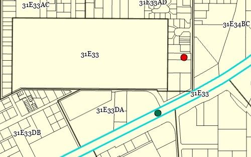

I am using the within() function to query an underlying feature class. Then calculating fields based on the values pulled from the within(). If the feature is an odd shape it will return nothing or the wrong value. I am using this syntax, within( querylayer   ,centroid($feature)). Sometimes the centroid is outside of the feature.
In the image below, the within function is using the red point to query the 31E33AD polygon. I need the function to query the 31E33 polygon using the green point. If I remove the centroid function, within() returns nothing.
Red is the centroid used by the within() function.Red is the centroid used by the within() function.
My suggestion is to create a function that uses a center point within the selected feature. Or fix the centroid function to place the point within the feature.

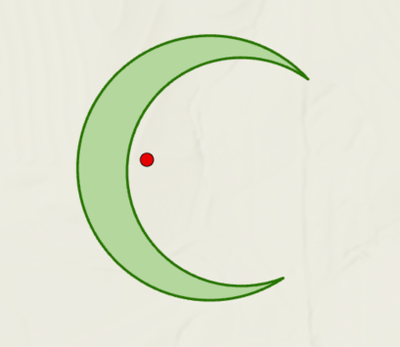

@JonathanMcDowell1 is the 31E33 polygon a curved or "moon" shaped feature such as below. When getting geometry of the centroid it is actually outside the feature.
I have run into this issue before and the solution was to create a negative buffer object with the Buffer() function then use that object as the innerGeometry for the Within() function.
Note: I noticed in your first comments you had within( querylayer ,centroid($feature)), this is reversed how you want it. The syntax for within is Within(innerGeometry, outerGeometry). In your case, would the innerGeometry want to be the centroid($feature) and the outerGeometry be the querylayer? within( centroid($feature),querylayer).
