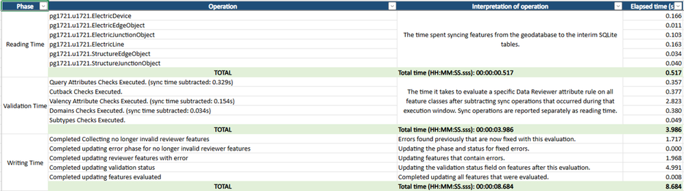

How the tool works
At a high level, every evaluation consists of three phases: reading, validation, and writing. Reading includes the time spent syncing geodatabase features into the temporary SQLite tables preparing them for processing. Validation encompasses the running of Data Reviewer attribute rules. Writing represents the tasks needed to update the geodatabase with results, such as recording new errors, updating fixed errors, updating existing errors, and updating the validation status field.
When Data Reviewer-based validation attribute rules are evaluated, ArcGIS Server uses several optimizations to process rules more efficiently. One of these optimizations is the creation of a temporary SQLite database that contains only those features and fields needed for the evaluation, allowing multiple Data Reviewer attribute rules in the same evaluation to use the same cached data. Similar evaluations can also be combined to improve overall processing efficiency.
The Reviewer Log Parser helps determine where time is being spent during the evaluation process. It reads ArcGIS Server log files from a selected folder and looks for Data Reviewer validation messages written by the ReviewerUtilities method. The tool then groups related messages by request ID, allowing each validation to be analyzed separately. For every log message, the tool captures the message text, timestamp, elapsed time, source log file, and line number. It also calculates a Unix timestamp to support chronological sorting and downstream analysis.
To support general awareness and deeper troubleshooting, the tool produces two outputs. The first is a CSV file that contains the output details of each log message as described above. The second is an Excel workbook that summarizes each validation run in a more readable format. The workbook opens with a README worksheet that explains the report assumptions, followed by one worksheet per request ID (named using the first 31 characters of the request ID). Each run worksheet lists the parsed operations, describes what each operation represents, breaks elapsed time into Reading, Validation, and Writing time in seconds, and includes phase totals formatted as hours, minutes, and seconds.
Note: When building the run worksheets, the parser tries to avoid double-counting sync time. If a sync operation occurs during a validation operation, the tool subtracts that sync time from the validation total and reports it separately as Reading Time.
