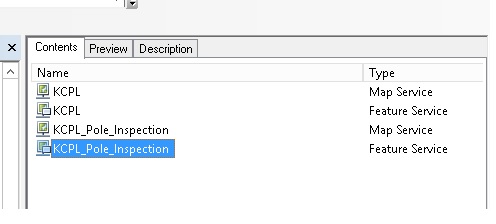

Hello!
I had the same problem and it has to do with the connection you are using. So you can publish with your current ArcGIS Server connection but then make another ArcGIS server connection that is designated as a "user".
Then when you view your published services you will see both the map service and the feature service:
Then you can right-click on the Feature service and make a layer.
