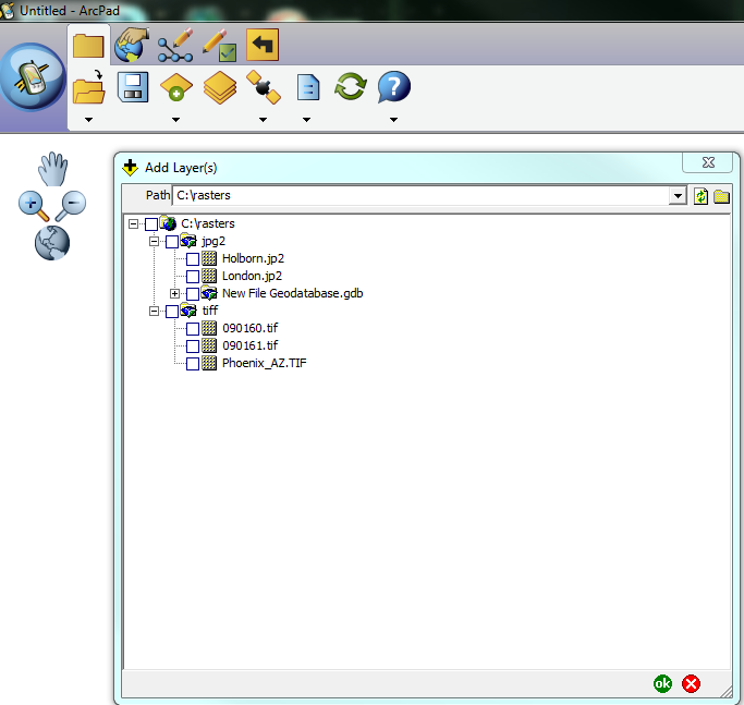

HI Gregg,
Here is my suggestion on your post, with regards to using a DEM with ArcPad. If your DEM is one of the supported raster format, found in the link provided. You can then use the general ArcPad workflow for it, as you would to add a shapefile, axf, etc. directly into ArcPad.
Gracias, Gregg!
Supported raster data
http://resources.arcgis.com/en/help/arcpad/10.2/app/index.html#//00s10000001r000000
Juan
