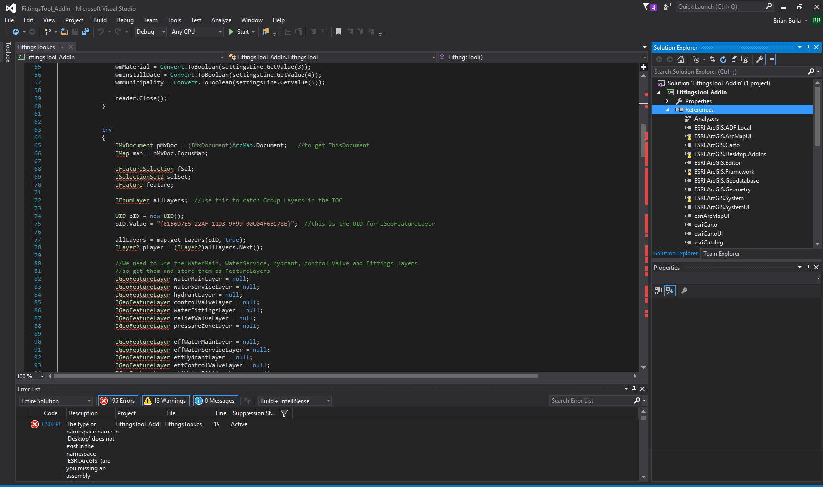

Hi,
So I just got my PC upgraded to Windows 10.  I'm not sure how the IT department loaded everything.  Previously I was using VS 2012, but now I have VS 2015.  When I open up an old 2012 project I have all sort of missing references, but even after what appeared to be adding them back, I still have 195 "Errors" with my project.
Any suggestions on how to fix this?  A re-install of the SDK??  My ArcGIS 'templates' within VS seem to be there.

Hi Brian,
To answer your question from the post on missing DLLs in the Runtime .NET forum, if when you go to Assemblies - Extensions and don't see any ArcGIS references listed, you likely either need to reinstall the SDK or browse to the location it is installed at and import the DLLs from there.
The DLLs should be located at:
C:\Program Files (x86)\ArcGIS\DeveloperKit10.x\DotNet
From the Assemblies - Extenstions window, click Browse... on the bottom and go to the above location to add the necessary DLLs. Hopefully VS will pick up the location after the first one and just let you check the boxes of the rest you need.
However, since you have a new version of Visual Studio courtesy of your IT, you most likely need to reinstall the  SDK to integrate it with this version of VS. You may need to check the System Requirements of the ArcGIS Desktop version to confirm it is compatible with VS 2015. Otherwise when you try to reinstall it you won't see it listed on the Setup page:
I believe the ArcObjects 10.3 SDK is the last to support VS 2012 so in order to use VS 2015 you may need to upgrade the SDK.

BrianBulla
Honored Contributor
Thanks Kimberly,
I tried updating the references as you suggested, but that still didn't work.  So then I did this:
1.  Uninstall 10.4 SDK
2.  Uninstall VS 2012 (so just 2015)
3.  Reinstall 10.4 SDK
Now all is good, and when I update the references they resolve all the errors.
Thanks for the help!!
