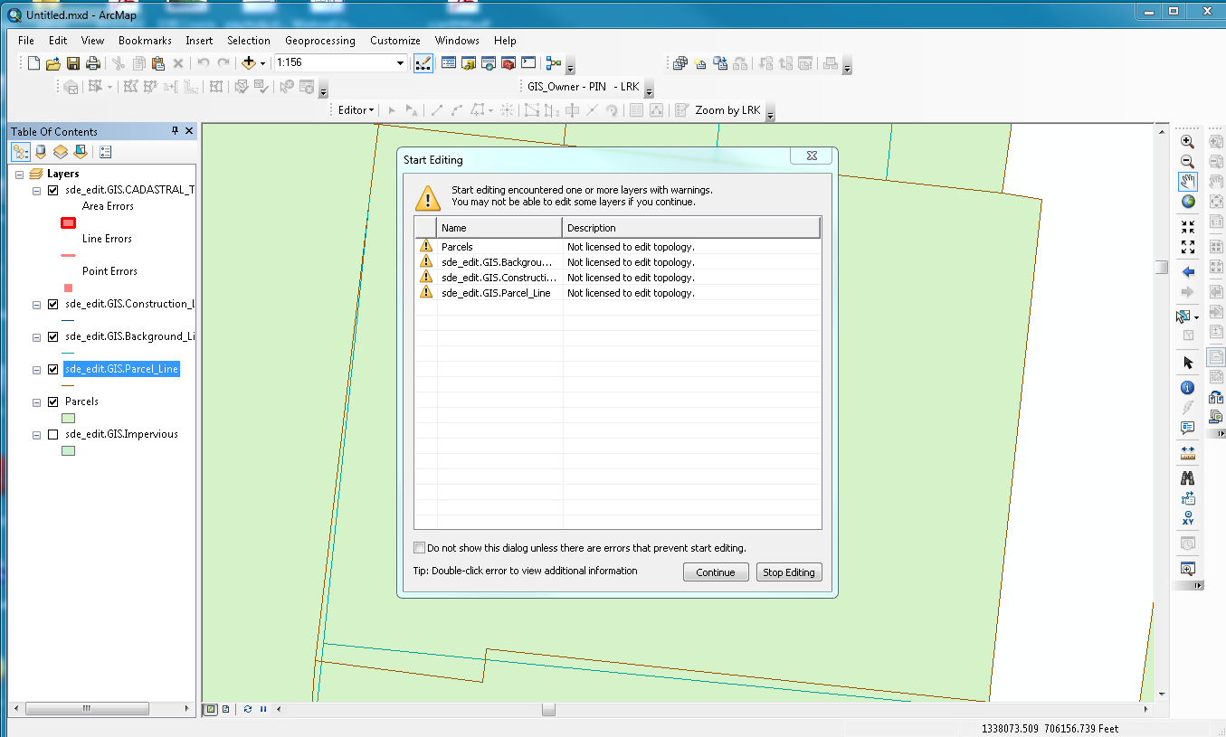

I have created an add-in to that takes in a unique ID, searches through the TOC for the appropriate layer and then zooms to feature with that ID. However, once that action is performed, I am not able to start editing any of the features in that Feature Dataset without warnings and errors. How do I release locks on these objects so that the main ArcMap thread can have access again?

  I'm actually using the Java SDK. I finally figured the problem out yesterday afternoon. I was using the arcengine license with my add-in. I used an out of the box sample for accessing the license. Even though we have desktop advanced, if you use an engine license, it downgrades the whole mxd for that session. I changed it to using the advanced license, and now I have no errors. Thank you for your response!
