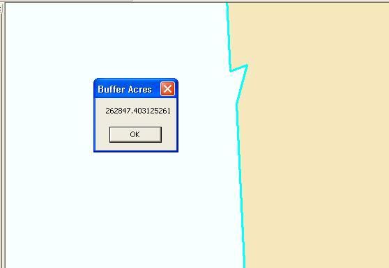

That error shows up somewhere in the depths of the ESRI web as an Internal Geometry Error, or something like that.  I played around with some of the vertices and found a single vertex that, if moved, it would run fine.  See attached image.  This is a tiny, 1-meter notch on one edge.  One of many similar vertices.  If I move the vertex and straiten out the edge, it runs fine.  There is no way that this little spot should cause a buffer to fail!  It runs at just about any buffer distance, integer or floating, except for right at or around 5 miles.
And there is no way that the user can or should have to go in and find the one little vertex that is causing problems.  This is the tail end of a long data processing routine, and it works on 99.9999 percent of the polygons.

I cannot seem to replicate the error you are seeing -- switching around the miles value from whole integers (5) to double values.  I even added a little 1-meter notch into the polygon per the image you posted, and still your sub/code ran without error.

I know, it's very strange.  I even went so far as to trace the offending polygon, vertex for vertex and still got the error.  If anyone wants to play, I've attached the file GDB.  There is only the one polygon in it.
