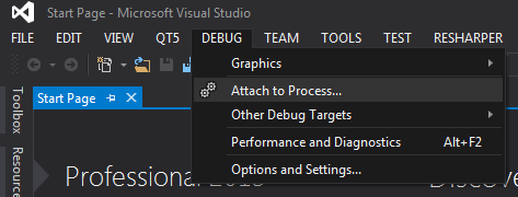

After you launch ArcMap, add break points to your code and then attach to process in Visual Studio to ArcMap.
When you press the button, you should be able to step through your code.
