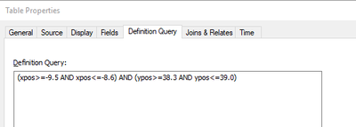

4. At this point I know I want a small subset of the data so I right-click on the ITable and under Definition Query I enter: (xpos>=-9.5 AND xpos<=-8.6) AND (ypos>=38.3 AND ypos<=39.0). Using this same exact filter in SSMS gets me 8000 records. I click on the Verify button and it says all is good.

7. This is not how the ITable conversion worked in the past or how it's intended to work. Why would I need all 11.5M records when my Query Definition filters to 8K records?
8. This is probably why my .NET code is "hanging" because the IQueryFilter is not being applied when the ConvertFeatureClass executes. It sounds like its copying all 11.5M records and just taking hours to process.

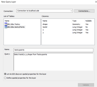

As a workaround, consider creating a view in SQL server ...
create view testxyPoints as
Select testid
	,x
	,y
	,geometry::Point(x,y,3857) as shape
from Testxy;

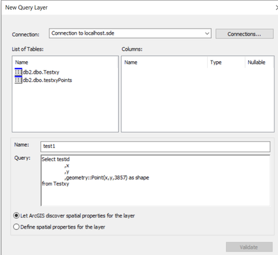

And then in Arcmap, instead of adding an XY layer, add an SQL query layer. (File> Add Data> Add Query Layer)
Then see if FeatureDataConverter can digest that.
You can also do it without creating a view ...

You can also do it without a view ...
KirkKuykendall1
Check the "Define spatial properties..." to speed things up, the "discover" option does a full scan of the query.

So on this test using the Query Layer I chose my connection and then my SELECT with my WHERE. It complains that my table doesn't have an OID, which it doesn't. I just choose STATEID which is a number but not unique to each record.
It converts it to an ITable. Then I can choose Display XY Data and I can now see that my selection of points is where they should be and it is definitely NOT the 11.5 million points in the source table.
