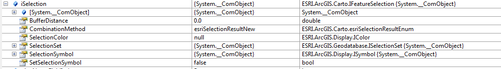

I have a bit of code that selects a line feature. If one opens the attribute table it does in fact show the line as selected; however, it does not show up as selected in the data view.
From VS debugger.
              rowIdentifyObj = (IRowIdentifyObject)featureIdentifyObj;
              feature = (IFeature)rowIdentifyObj.Row;
              iSelection = (IFeatureSelection)pipeCenterlineLayer;
              iSelection.Add(feature);
Do I need to set the SetSelectionSymbol to true?

Did refresh the display? I would assume that you'd need to make a call to IActiveView.PartialRefresh(ESRI.ArcGIS.Carto.esriViewDrawPhase.esriViewGeoSelection, null, null);

Sorry, it took me a few days to get back to the project. The partial refresh did the trick! Thanks for the help.
