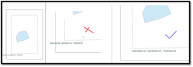

I am working a project, where need to show photo-index number and inside polygon name at lower left and upper left corners.

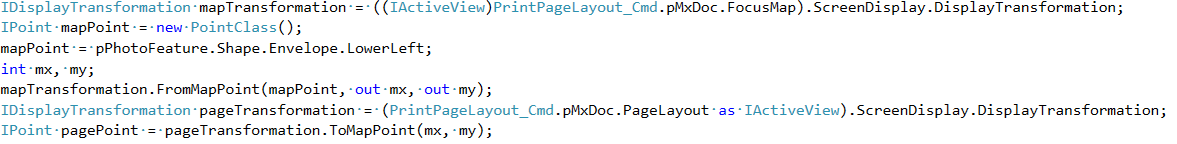

I have written a tool to export page layout view into A4 size PDF , but I unable to align text element exactly the above mentioned corners, able to get XY coordinates of a polygon in page layout units in inches .

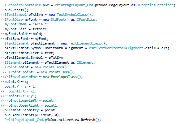

Using these XY coordinates I tried to place text element at lower left or upper left corner, but text not aligning to exact point, text element taking mid point as start point.
So, how can I align this text exactly at given XY coordinates.
please look into the below code:
