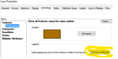

how do I edit legend label of the layer? (C# SDK)

The class that is your friend is ISimpleRenderer.  The Label property should be the label that appears in the table of contents.

Thank you for reply.
I am trying to edit or remove that "EXISTING PIPELINE ROW,....". But could not find a way.
