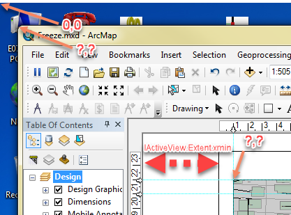

I'm trying to get the pixel location of where the upper left corner of the ArcMap application is and more importantly the location of data frame on the page layout.  How can I do that in ArcObjects?  If, for example, ArcMap's upper left corner is slightly away from the screen's upper left corner, how do I get that offset and where does the data frame start (in pixel space relative to the screen's 0,0 position) ?   IActiveView:Extent.XMin seems tells you how far the PageLayout is from the left edge of its container, but I don't know how far that container is from the left edge of ArcMap or how far ArcMap is from the left edge of the screen.

I've got it solved (to my satisfaction) with the code below.  To summarize the goal was essentially to take a screen capture of the data frame (map) when in page layout view. There's some additional code (not shown) which then puts the dataframe into "draft mode" and then plops the screenshot as an IPictureElement on top of the data frame.  This methodology essentially "freezes" the data frame so that when people are panning/zooming in page layout mode, they don't have to wait for the screen to redraw at all, but they can still see their map (albeit pixelated when they zoom in).  There's more code (not shown) which removes the screen capture image and puts it back into regular "live" update mode.

DuncanHornby
MVP Notable Contributor
This sounds like a question more suited for stack exchange as the position of the window relative to the screen display is more of an operating system "thing", found this thread, this should help?
RiverTaig2
You are partly right for sure - I can probably use the technique suggested in the stack overflow thread to get the ArcMap application position. But I'll still need to find the page layout using ArcObjects i think
