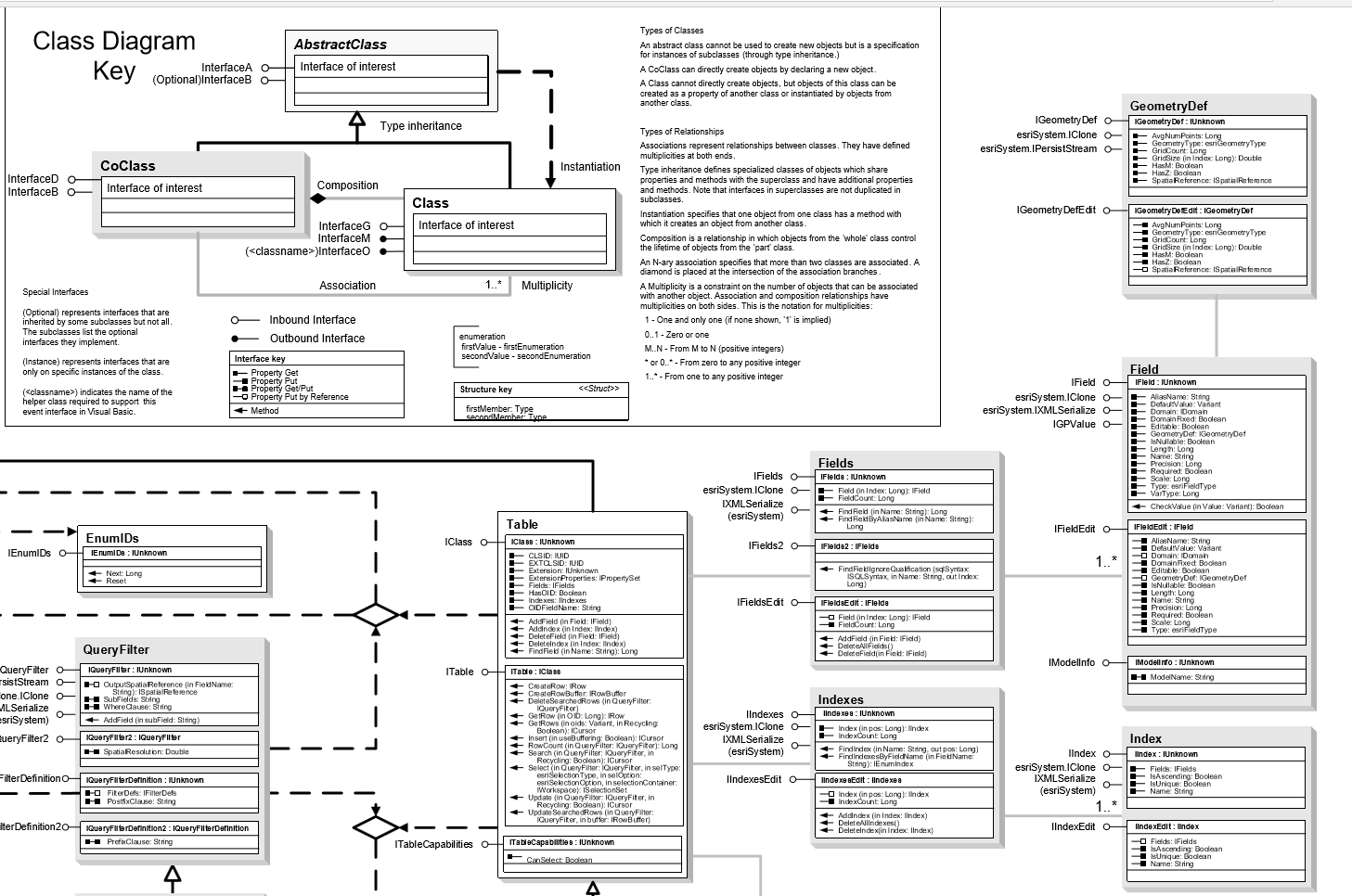

nicogis
MVP Alum
In general for understand the relation among them you can see Reading OMDs
You can access OMDs from the Help system's table of contents (TOC) by clicking the Namespace reference node, expanding the node for the applicable assembly, expanding the node for the proper namespace named node, then clicking the applicable <Namespace> Object Model Diagram node
for example for geodatabase : GeoDatabaseObjectModel
